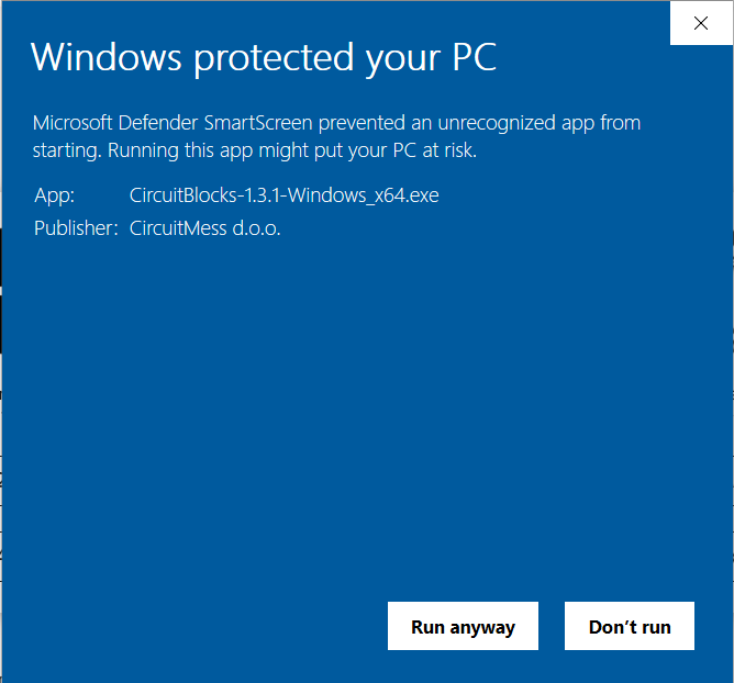

Your PC is not at risk!
There is a possibility that a notification that says your PC is at risk may pop up when you try to install CircuitBlocks. Don't worry, this happens regardless of CircuitBlocks being safe to run. See the instructions below on how to handle this notification.
This is the message you might get when trying to install CircuitBlock on your PC.
Windows reports a threat despite the program being safe to download and run.
Please proceed with installing by clicking on 'More info' option.
After you click on 'More info' option, an option to 'Run anyway' should appear at the bottom of the window.
Proceed by clicking on 'Run anyway'.

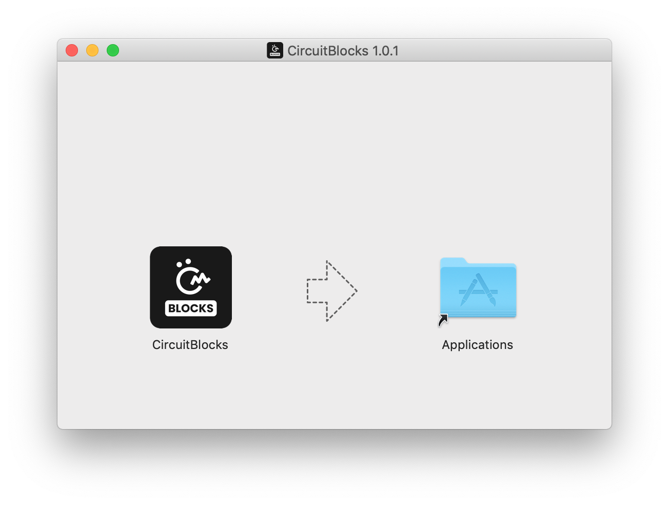

If you have a Mac computer
- Go to the CircuitBlocks download page
- Download the latest version of CircuitBlocks for Mac OS (the file named "CircuitBlocks-1.0.1-Mac.dmg" or similarly should be downloaded)
- Move the files to the ‘Applications’ folder
- CircuitBlocks will be installed automatically
