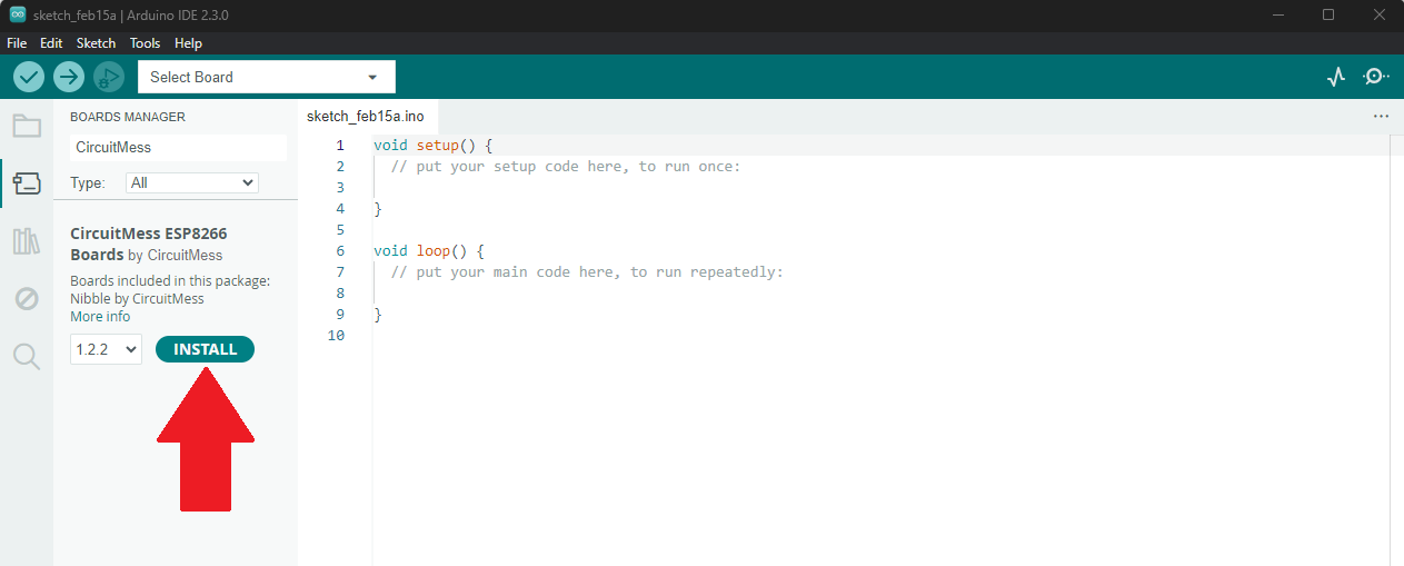

  5. Open the Board Manager under Tools -> Board -> Boards Manager
  6. Type 'CircuitMess' in the search bar
  7. Click the Install button on the CircuitMess ESP8266 Boards package
