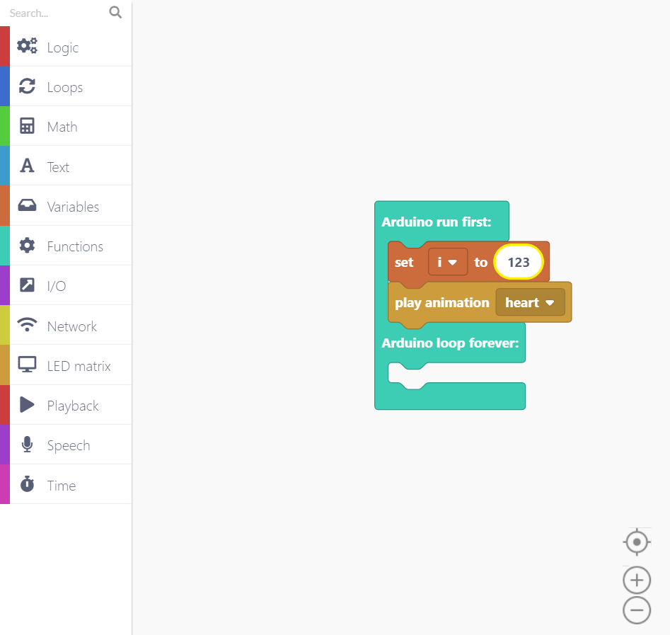

Find this block named "123" in the "Math" section. This block is a numerical value block, and you can type in the numerical value you want once you drop it onto the drawing area.
random image
Place the block here:
random image

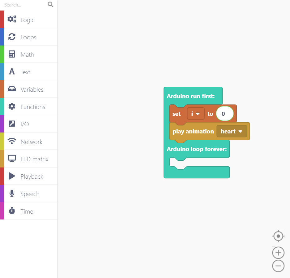

Now click on the block and type in the value. Set the numerical value of the block to 0. You can do this by simply typing the number 0 (zero) on your keyboard.
random image

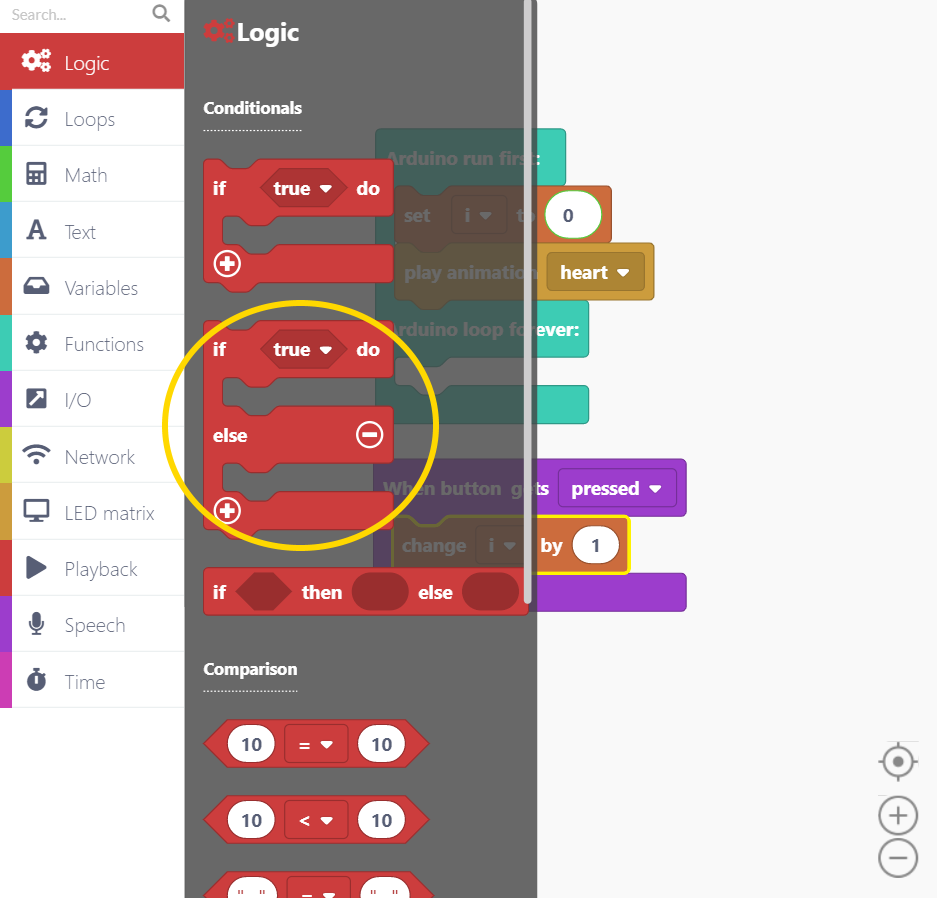

Now let's do something interesting - we'll use a logic IF-THEN-ELSE block to show different animations on Spencer's face depending on the value of the variable that we're changing.
Find this red block in the "Logic" section:
random image
Place this block into the purple "When button gets pressed block".

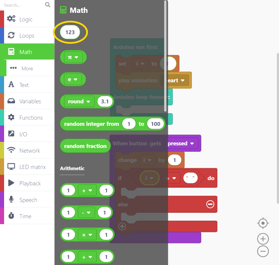

Take the numerical value block from the math section and place it to the right side of the comparison block like this:
random image
random image
Write the number 1 into the block.

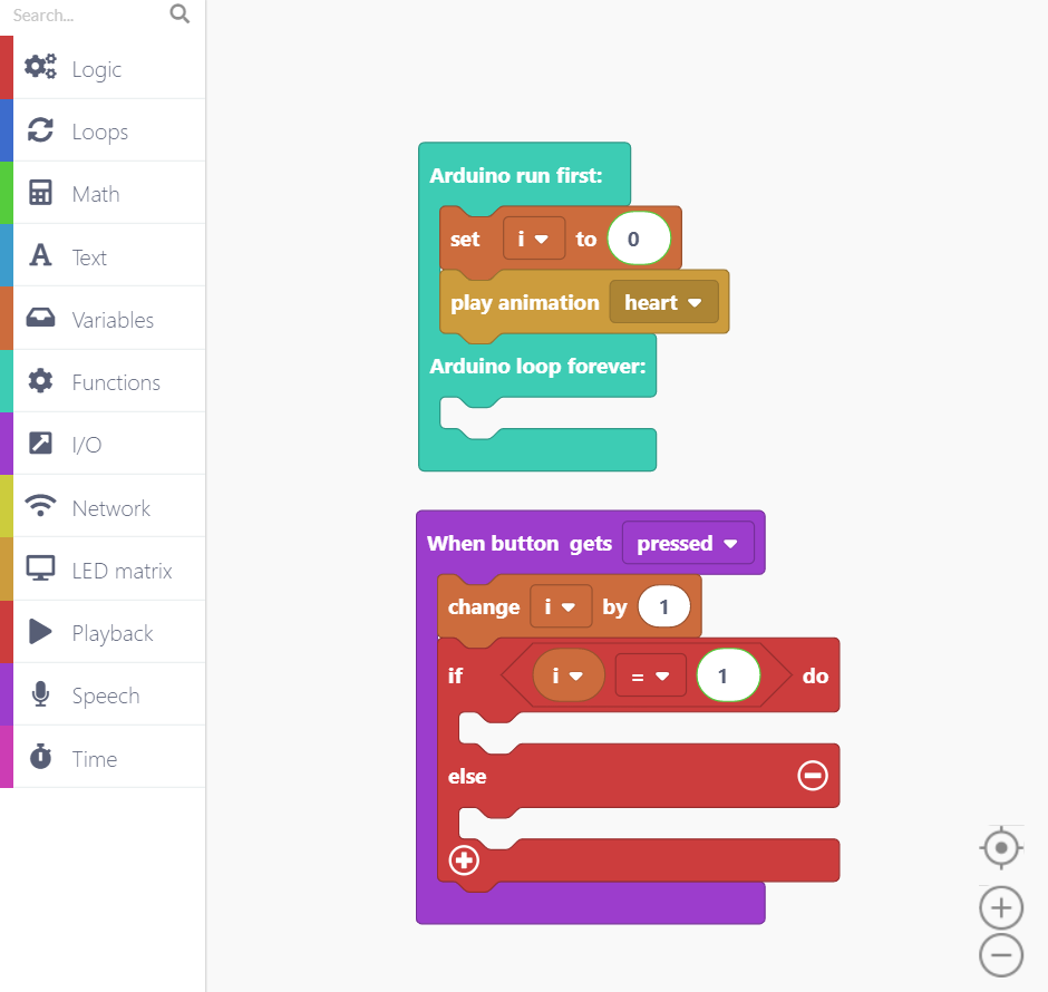

I'm going to fill out the other logical branches like this as well and assign different animations to different values of the variable:
random image
Here's the catch - if we want Spencer to cycle through these seven animations, we need to reset the value of the variable back to zero once it goes above 6.
We can do this by simply adding these two block to the ELSE branch of the logic block:
random image
These two blocks will reset the value of the variable to zero and play the initial animation that the program started with (the "heart" animation).
If you've followed everything correctly, your code should look like this at the end:
random image
