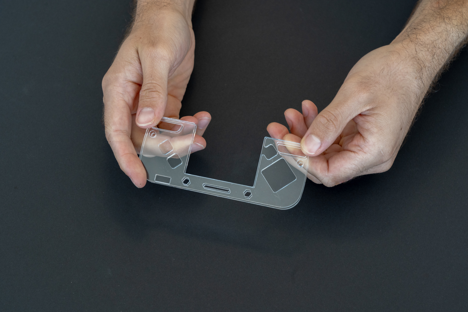

 Removing protective layers
Peeling off the edge of the layer is the easiest way to go
In order to peel them off, take a toothpick, or your nail, (but not any metal or other sharp objects) and carefully scratch off a bit of the cover from one of the corners of the casing. Once that is done, take the plastic with your fingers and slowly peel it off the casing. Satisfying? Oh yeah!
Slowly take off the protective layer so it doesn't break midway
You’ll notice that the casing is still not completely clean. There is also a layer of this plastic on the other side. Each casing has two of these protective films, one on each side. That means that you have to take off a total of twelve plastic covers before continuing.
Make sure to remove the layer from both sides of the casing
Casings after the protective layers have been removed
When all of the casings are nice and clear, continue to the next step.

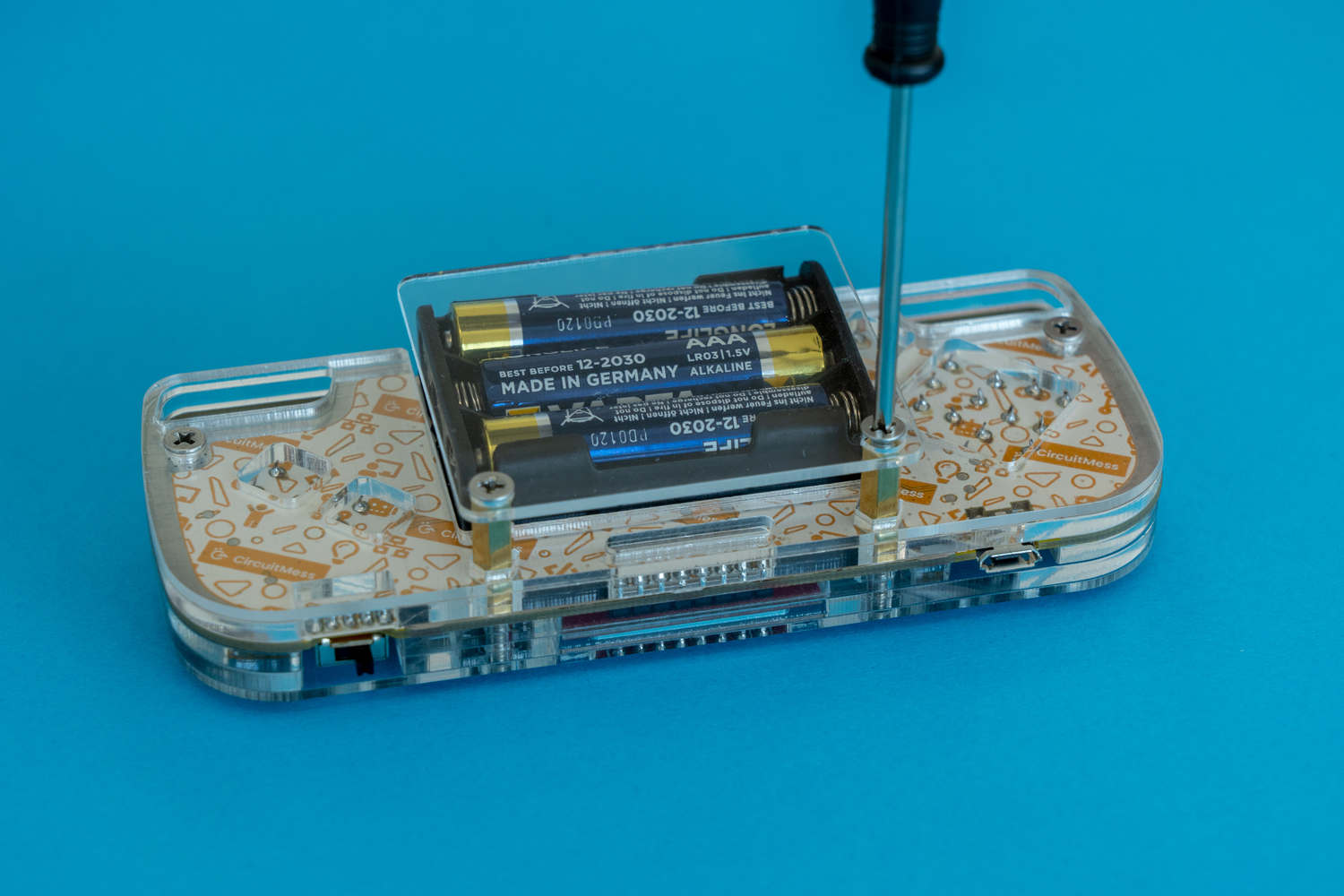

If the batteries are already inside the battery holder (which they should be from the chapter - first check) then you just have one final step left!
Putting the plastic cover on top of the batteries
Take another two smallest 6mm bolts and screw them into the spacers, so that the battery plastic cover gets nicely tightened up.
Tightening the bolts on the battery cover
Use the screwdriver to tighten all of the bolts if necessary additionally.
