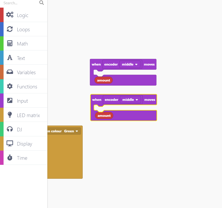

Now, let's code the changes we'll make with the slider.
For that, we'll need the I/O block, inside which we'll insert the code for the slider changes.

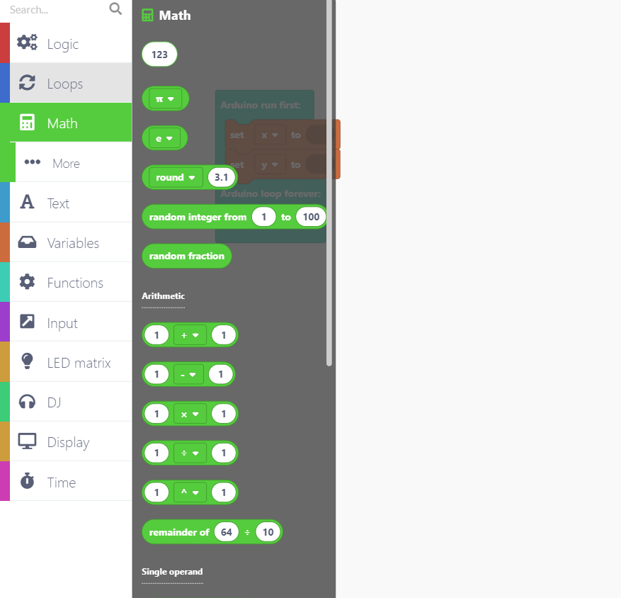

We want to save the slider's current position (which can range between 0 and 235) every time we move it.
Then, in the form of ratio, we wish to store that value in the "width" variable.
Make a new variable called "width_display". Store the above value in the variable "width_display" as a percentage.
