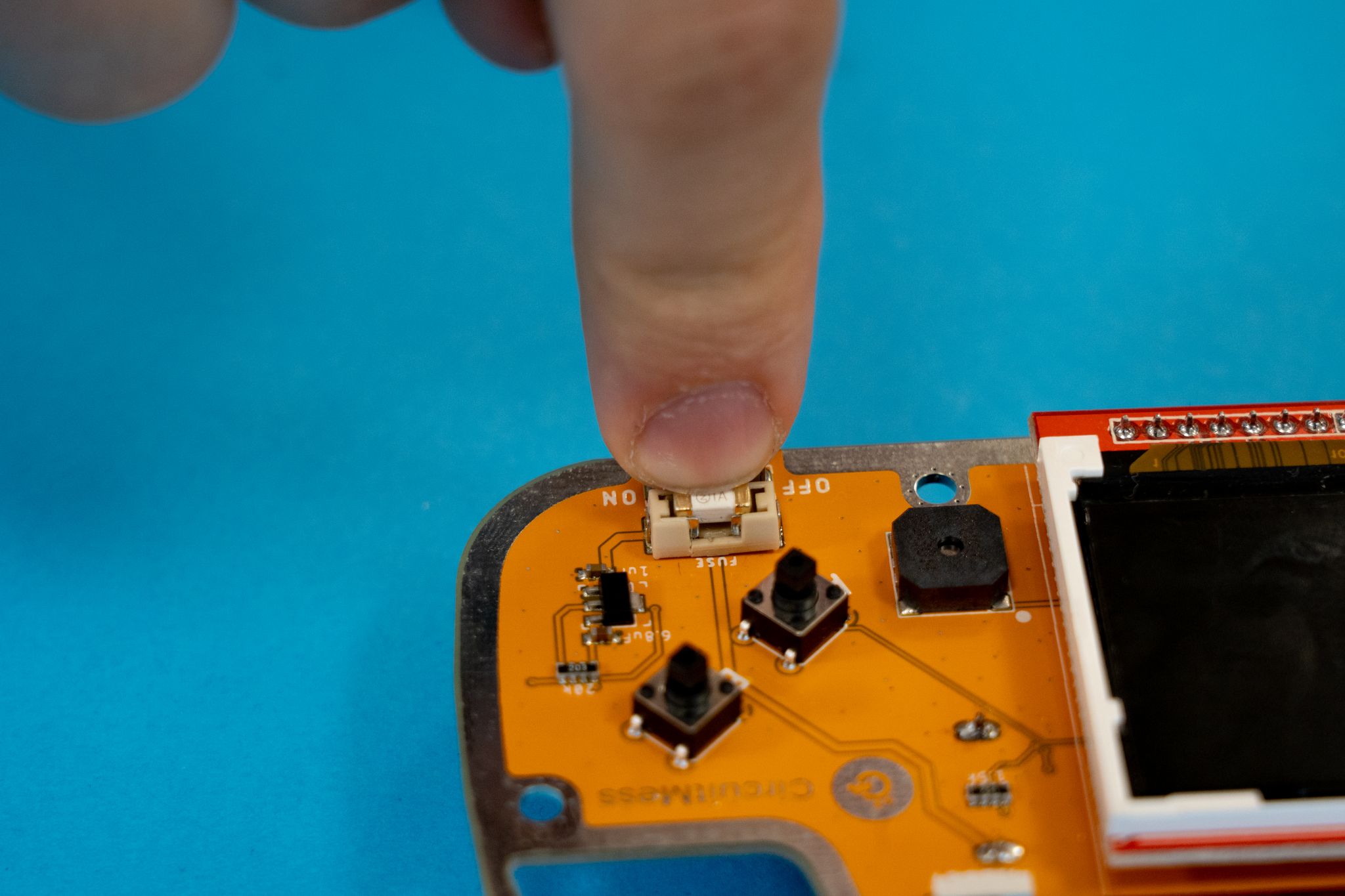

Fuse
Before turning your Nibble on, you have to insert the fuse that will keep all of the components untouched if something goes wrong inside the circuit.Â
There are a total of three fuses and they can be replaced if needed as well.
Take one of the fuses from the package.
It doesn’t matter which way you put the fuse, as long as the little black text on it is facing upwards.
Put the fuse in a little holder right next to the buzzer.Â
Remember!
Putting the fuse in its holder might be a bit tricky because you need to use a bit of force. Don't be afraid to push it inside. As long as it's facing upwards, your fuse should be fine.
Push the fuse inside
If you can put the fuse in by using your fingers, use a toothpick or another thin object to do so.
